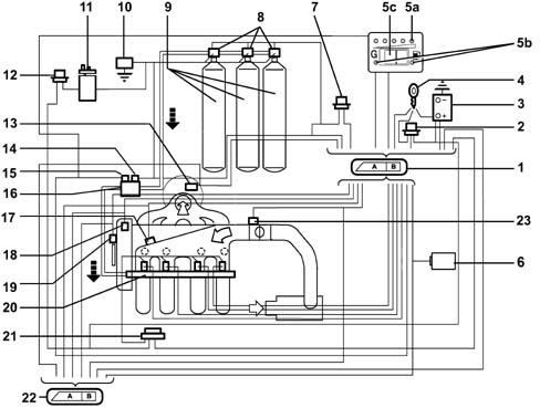

СообщениеДобавлено: Чт Фев 28, 2013 18:52    Заголовок сообщения: Ответить с цитатой
1 - Methane engine management control unit
2 - Injection system relay
3 - Battery
4 - Ignition switch
5A - CNG residual pressure indicator (SEDIMO)
5B - Two LEDs for 'petrol mode' (yello-amber LED) and 'gas mode' (green LED) (SEDIMO)
5C - Petrol or methane operating mode selector (SEDIMO)
6 - Body Computer (diagnostic socket and Fiat CODE signal)
7 - Methane solenoid control relay (on cylinders and on pressure adapter)
8 - Solenoids on cylinders (three solenoids for the Doblò Cargo version, two solenoids for the Doblò version)
9 - Methane cylinders (three cylinders for the Doblò Cargo version, two cylinders for the Doblò version)
10 - Inertia switch
11 - Petrol pump
12 - Petrol pump cut-off relay
13 - Lambda sensor upstream of catalyzer
14 - Solenoid on pressure adapter
15 - Methane pressure sensor
16 - Cut-off solenoid on methane pressure reducer
17 - Pressure and air temperature sensor
18 - Engine timing sensor
19 - Engine rpm and TDC sensor
20 - Methane supply manifold with injectors
21 - Injector supply relay
22 - Petrol engine management control unit
23 - Throttle valve position sensor
